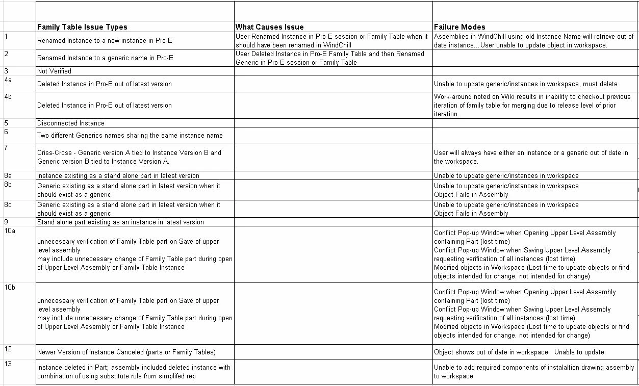

See the attached presentation for a couple scenarios you may run into wth famiy tables in PDMlink. The specific one I believe you need for this case is the "reconnect" solution. If your company combined a couple intralink databases into PDMlink environment, you may see a couple of the other issues in the presentation.
To diagnose the issues and identify the family tables with issues, I selected a top level assembly and used add to workspace with required dependents...in the add to workspace window, go to the advanced tab to see the "messages" which will provide out of date details or conflicts. From there, it's a matter of becoming familiar with PDM link functionality of search and history of the instances.
Best practices for users -
  1. never delete instances
  2. when itererating the generic, always iterate and verify the entire family table before checking in.
  3. teach users to not accept "marked as modified, but untouched" conditions when working with family tables...repair them so the user community is not constantly managing modified objects in the Workspace.
I also inserted an image that summarizes the multiple different failure modes that you can see with family tables in PDMLink environment coming from Intralink. Half of the issues require Admin priveledges and based on my experience can take hours to repair each case as much time has to be spent diagnosing which case you are dealing with first.
