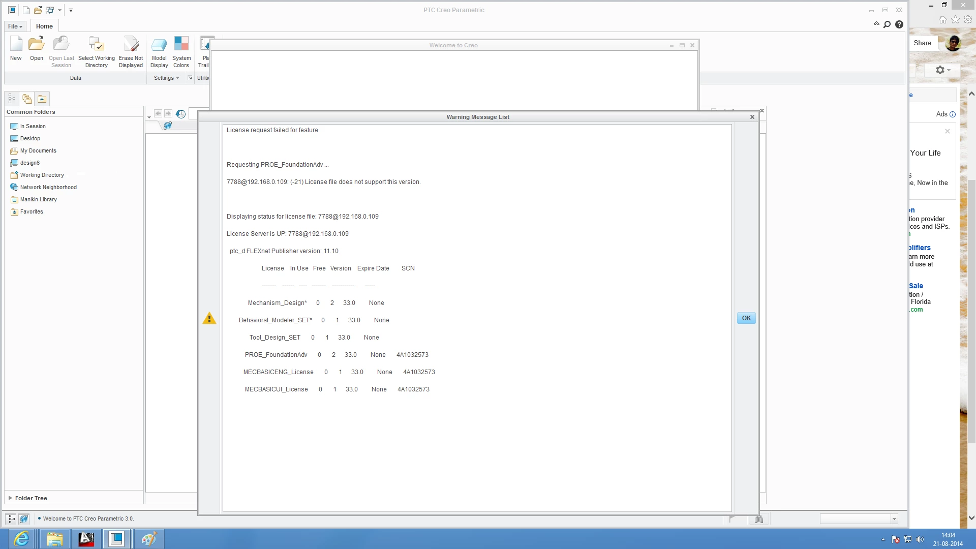

Ok , I have a problem here. I had been using creo 2.0 for which I had setup the license in the server machine. All my client machines were able to use it.Now I have an upgraded license of creo 3.0. I have installed the same on my server (the same having creo 2.0). I inserted the creo 3.0 media - went setup new license- dragged the the file to the location and finished it. But none of my client machines (including the sever machine) is able to work on it. It displays a message "license file doesnt support this version"(may be it is still tracking the old license). Do I have to uninstall the previous version?? can any body help me with the correct installation procedure ?? ( image showing the warning message)

You will also need to upgrade your license file for use with the Creo 3.0 license file. You may also need to update the license manager.
You show version 33. Creo 3.0 is version 34.

I suggest you ti uninstall FLEXnet on license server, restart server and install FLEXnet once again.
