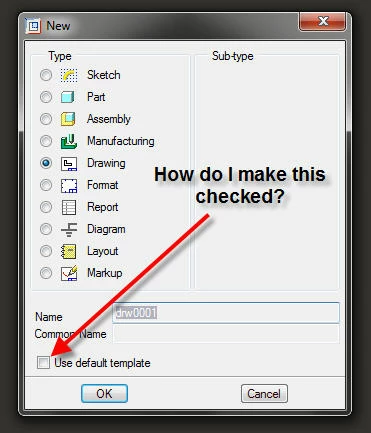

Proe Users,
In previous versions of Proe when I create a new drawing from a part the
"Use default template" box is checked. I have not changed my config , and
now in Wildfire 4 this is unchecked by default. How do I make it default to
checked?
I think I remember this being very simple but can't find the option. I have
been on Solid Works past 3 years.
Thank you
