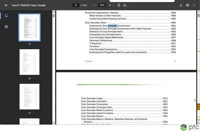

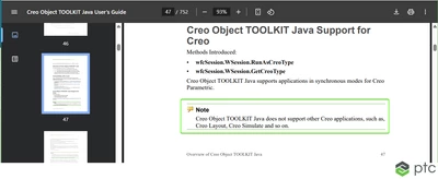

First and foremost here is the state of the art from the Java Object Toolkit documentation :
Accessing Creo Simulate is indeed not part of Creo Java Object Toolkit Free functionalities
From Creo Toolkit (C langage) though some entery points are granted according to the documentation :
But from a glance, the functions enable mainly to interrogate the environnement (get) and set some bits and pieces here and there.
No signs of a "ProRunAnalysis()" function though.
