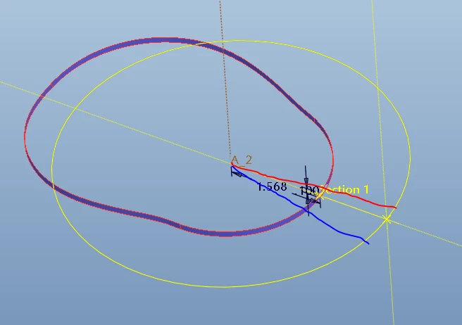

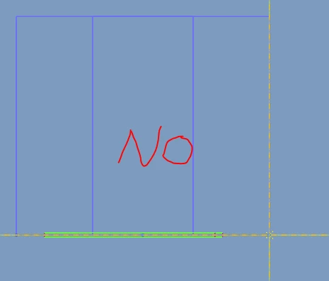

Is there any way to create a variable section sweep with the section parallel to the trajectory? I'm using a circle for the trajectory. To properly create the geometry I need to sketch looking down at the circle, not at a section normal to the curve. See attached pictures. I'm using the trajpar function with a graph, so I believe it has to be a variable section sweep. Thanks.

At different points around the trajectory the section needs to occasionally lead or follow the current trajectory position. That's why I wanted the section "looking down" at the plane through the trajectory, not normal to it. (See first picture. Red line would be leading the trajectory position and blue line would be lagging.) This would create a flat, planar surface. The resulting surface would be created at a different "rate" than the trajectory motion, but it would never overlap on itself.
[cid:image002.png@01CEC997.9827E880]

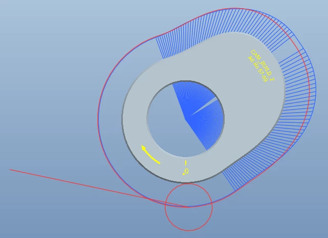

I was trying to create a cam surface compensated for the arm following it. (Cam profile is driven via a graph and the trajpar function.) I was hoping to do this with a single VSS feature. Currently I have to create a point sketch, pattern it 360 times, and then create a sketched spline through the points. (See second picture. Blue curve is desired arm movement - math profile. Red curve is compensated for follower arm length.)
[cid:image001.png@01CEC996.7A2474D0]
