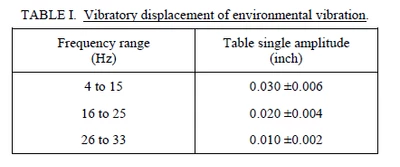

I am trying to perform a Vibration Analysis on an assembly in Creo Simulate (in Creo Parametric Version 10). The only input data I have is the Vibration Amplitude vs. Frequency table below. I was wondering if it is possible to do an analysis in Simulate with this type of data. Is so, would it fall under the "Shock" category under the  "New Dynamic" analysis option? Or would it be under another category? An input on this matter would be helpful. Thanks.

If  I were you, I will do as below.
1. Translete dispacement to acceleration.
2. Do frequency response analysis.
