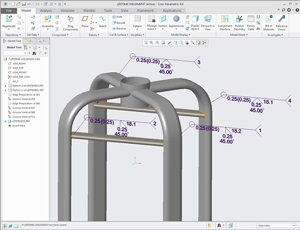

Anyone try the new weld functions in Creo 4.0 ?
Couple questions, 1. modifying note behind the tail & 2. edge prep: specifically where the cut should exist in the part or as a cut in the assembly.
Tail symbol
If one wants to modify behind the tail of the weld symbol in Creo 4.0 weld tool (not a drawing symbol) With a symbol in drawing it's easy. In Creo 4.0 weld tools however I struggle modifying from the default number into a note. Ideas how to modify behind the tail of a weld symbol (not drawing symbol)  Notice in the attached picture that tail counts 1-4.  Since that tail area is for added notes I should be able to modify that note from a digit to a legitimate note.

I figured out how to change the reference on the weld symbol. To add your text  you have to create a weld process and assign it to the weld. In the weld process dialog you can put your note in the "Specification number" field. you have to regen for the symbol to update with the new note. On mine it still showed up with a number in front of the note until I went Preferences in the weld ribbon and selected General on the left and the General tab in the Preferences dialog and unchecked "Display sequence ID". This will keep the number from showing on weld symbol tail..I think. I noticed when I check the box again the number doesn't show back up so now I am wondering if that is the correct box to uncheck. I can't decide if this is working as intended or a work around 😕
June 28, 2017
I now see that what I really did to make the number go away was to redefine the weld and under options I unchecked "Display Sequence ID"
