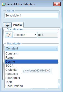

Can you have one servo rotate in both directions... I have a motor which rotated 180 degrees and then reverses and rotates back to the home position. How can I do this in MDX ?

You can define the profile of the servo as a function or table to have the servo move in two directions:

Thanks for you help... it took me a little trial and error but I got it to work...
