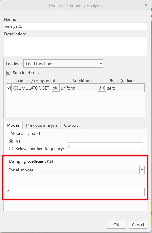

here my example
From "Help Center" - "Damping Coefficient (%)": https://support.ptc.com/help/creo/creo_plus/usascii/simulate/simulate/damp_coeff.html

skunks19-TanzaniteAnswer
here my example
