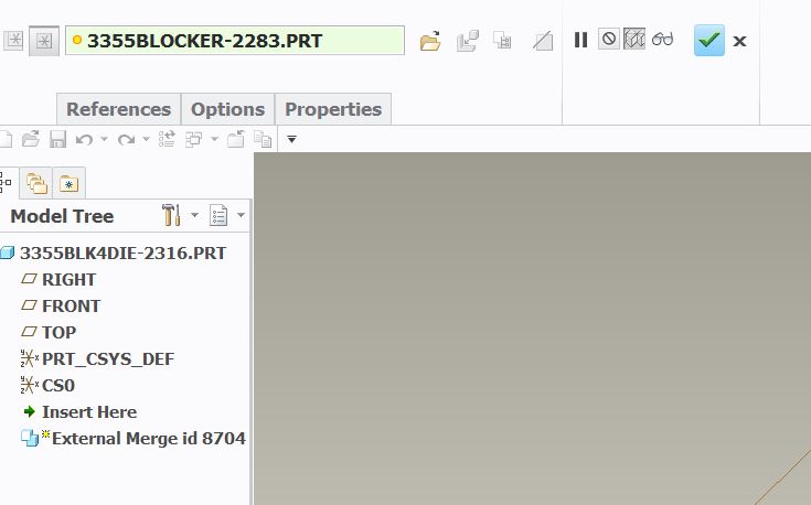

I have a part model that includes an External Merge.
I need to Replace one of the parts that gets merged.
There is no option for "Replace" in the tree so I choose "Edit Definition".
The merged part shows up top in a selection box "as shown".

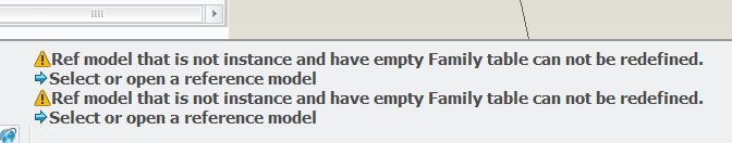

On 1st look there is no option to replace out the model. However if I right click in the selection box I get the "Replace" option which I click. I would think this would allow me to open up the file just to the right of the selection box, but it does not allow it to open so I could pick a part as the replacement. Instead I see the following warning dialog at the bottom of my screen.
Presently I am deleting the External Merge and reinserting the newly revised model file. I'm thinking it should be possible however to Replace out one model for another. How would this be done?
