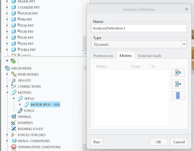

Why can't add a motor when it's dynamic analysis?
(Creo Parametric 10.0 ) Before I do the analysis definition, I already add a servo motor. However, I can only use the motor when the type of the analysis is position. And the right three buttons can't be used.

This means the servomortor you defined is a geometric and not a motion axis.
