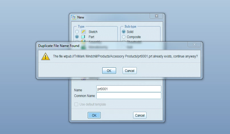

I guess I would not expect a search to reveal a part in someone's WS,
but when someone does a File, New, and enters a filename that exists in
someones else server side WS, I was under the belief that it would warn
you right up front.
Are my expectations correct? How is this really supposed to work? Are
they settings that need adjusted to allow this inter-workspace
visibilty?

I think that the config option: disable_search_path_check affects this ability. You would need to disable the option, which enables the functionality. (Set to no.)
