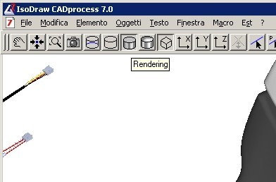

Is there a way to tell CadProcess to open a 3D drawing (an IGES file for example), in Wireframe instead of RENDERING as per default?
I could see that opening a drawing in that way, speeds up the opening from 20 to 35%.
Many thanx
Flavio

    You should be able to do this by going to Edit | Preferences and then scrolling to the '3D Options' portion of the window. Then click on the '3D Options...' button and choose what type of view you'd like to start with.

    Nope, that's the way Isodraw convert the 3D files into an Isodraw file. I am talking about the way Isodraw diplay the image on the screen.
    I meant Rendering instead of Wireframe.

    I don't see a way to set that. The closest I've come is to have a simple, two line macro. Problem is that this only sets the initially view once opened versus before you open.Because of this, it does not address the opening speed.
    Macro 3D_Import
    Open
    3D Mode HLR
    End Macro
