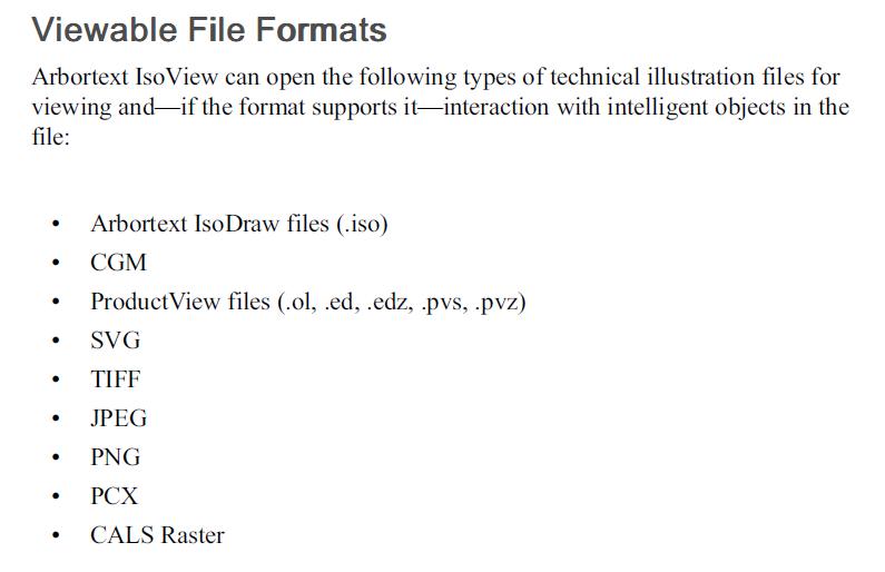

I just installed PTC Isoview on my computer. However, I couldn't find a listing of what 3D file formats the software can view. If anyone knows, your help is much appreciated!
~Michelle
June 21, 2011
Hello!
Last version of program Arbortext IsoView 7.2 supports following formats of files (this information is taken from a manual "Arbortext IsoView User's Reference", can be found on site PTC in section "Reference Documents": http://www.ptc.com/appserver/cs/doc/refdoc.jsp😞
Among the specified file formats, following formats 3D can be viewed: files Arbortext IsoDraw (3D illustration) and Product View.

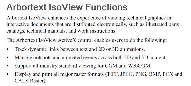

P.S. Also please take a look at this document: http://communities.ptc.com/docs/DOC-1534
