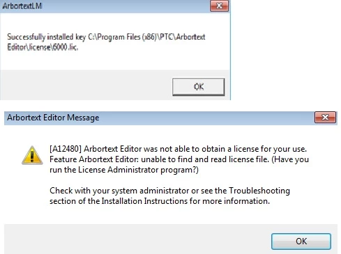

6000.lic is not available in the license folder though the key is installed successfully
Installed the editor license, system showed that the key is successfully installed. but could not seen the 6000.lic in the license folder. have tried to install the key but system display a key have been installed already. not able to open the editor.

    Are you using 5.4 or earlier versions of Arbortext Editor?
    Your license appears to be installed on a license manager. If that is true, then do you have the environment variable APTLMHOST pointing to the license manager?

    Tim,
    Yes, I am using 5.4. The issue has been fixed.
