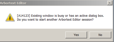

We are getting the following alert  in Arbor Text when we open multiple files in Arbor Text editor.
Existing window is busy or has an active dialog box.Do you want to start another ArborText editor session?
Earlier this seems to work.but not sure what happened,it suddenly gives the alert as below.
Could anyone help me in this regard.

On the executable  add -newinstance if you want style also -styler
Sample
"C:\Program Files\PTC\Arbortext Editor\bin\x64\editor.exe" -styler -newinstance

That would have been a good idea to tell you where to make the change. Find the Arbortext shortcut on the desktop, right click and choose properties in the target line  add the -styler -newinstance commands to the editor.exe exectuable.

Does this happen when you are using object Browse from Arbortext Editor or are you clicking  the Open In Arbortext from Windchill?
We recently discovered if you are running Arbortext as "Administrator" then when you try use the Open in Arbortext Action or button in Windchill we get the error you have shown.

Open the help center and search for Startup Command Syntax.
  • -newinstance — Makes it possible to run simultaneous sessions of PTC Arbortext Editor and PTC Arbortext Architect (assuming adequate licensing). To do this, the startup command must include the -newinstance parameter.
    Examples:
  • editor -newinstance
  • editor -architect -newinstance
