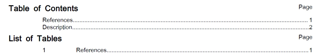

Ok I updated the AAD Print Services stylesheets to 4.4 M090 (14099). The extra white pages which appeared at the end of Data Modules have disappeared. However my Table of Content issues have changed.
In 4.3 M060 and 4.4 M080 I got a partial Toc in each Data Module. Some of the titles of levelledPara were listed, after which the remainder did not appear in the Toc. Now the situation is somewhat worse as "References" and "Description" appear in the Toc of a Data Module
[cid:image001.png@01CFB092.0A97AD60]
Is this by design? I have 14 tables and 18 Figures listed from the Data Module, information code 030, but none of the titles for levelledPara show up. I think they should.
Greg
