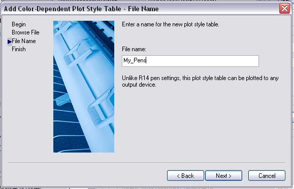

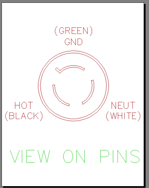

    We use WMFs produced with AutoCAD where the lines are a zero line width. It works great for our IETMs, works fine with Print Composed through Adobe Acrobat PDF print driver, but in Compose => PDF File to the PE version 5.4, the lines come out way too thin on the screen and barely dark enough in print. I’ve tried a few pdfcf changes to compression and downsizing using the various pdfcf files for example, but that only seems to affect jaggies.
    Anyone with some zero line width experience that can point me in the right direction?
    Printing to logbook/pocketbook sized manuals isn’t a supported page size under our Adobe drivers and they all rotate 90 degrees, so…we can’t use Print Composed like we usually do.

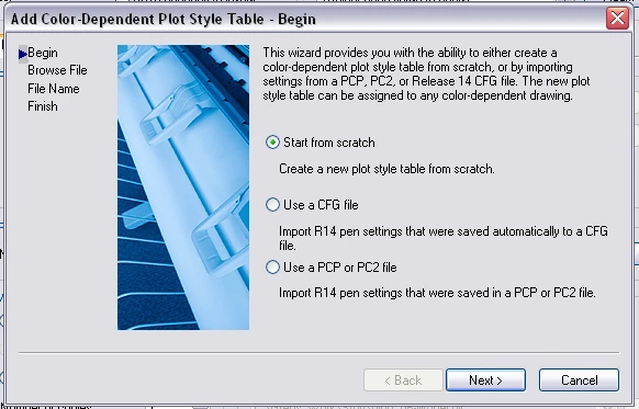

    Hi John,
    I’m not sure if there is a bulk way to handle this via programming.

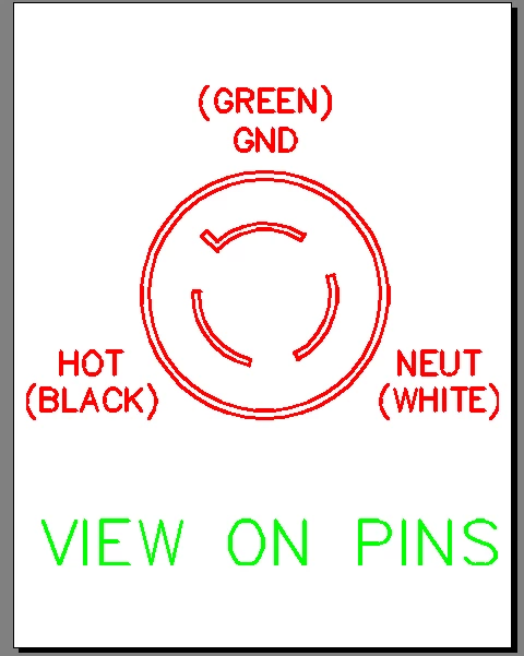

    I do get a very similar complaint about eps files created by autocad. The line weights typically are too thin and light when the eps graphic is inserted into MS word for example.

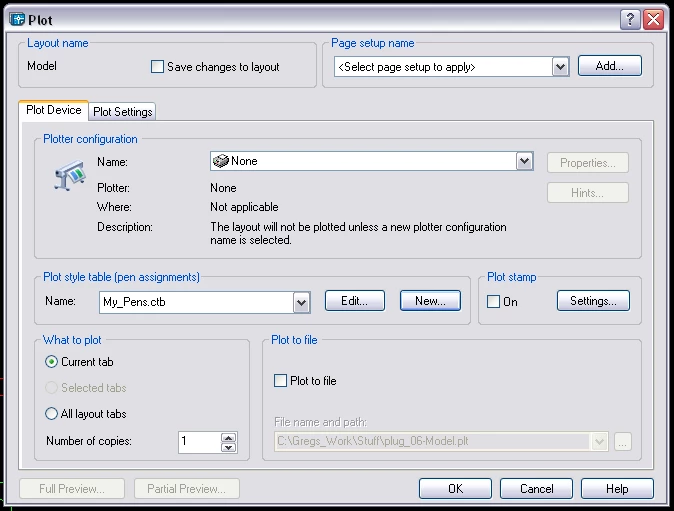

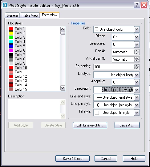

    My response was to use a custom line weight when plotting. When plotting choose plot device, and you should see Plot style table (pen assignments). It may default to nothing or acad.ctb. Click on new.
    Select Start from scratch, click on Next.
    Give it a name, click on Next.
    Click on Finish

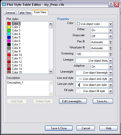

    You should see My_Pens.ctb now in the dropdown field, click on Edit.

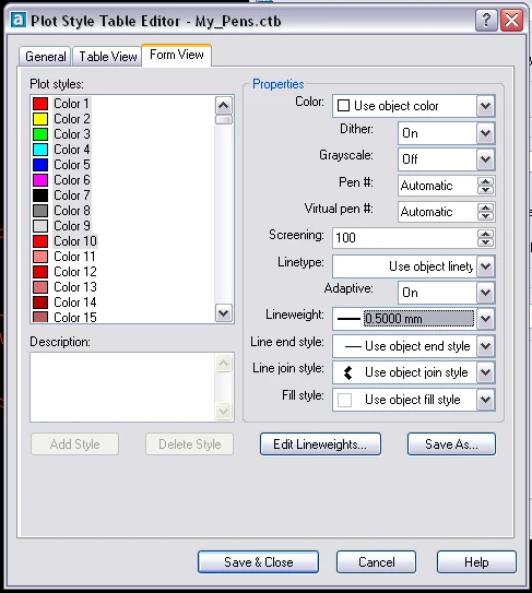

    Typically, the first 10 pens are used in a drawing.
    Select Color 1 and shift click on Colour 10 to select the first 10 pens. In the lineweight field, choose a value that is appropriate to the thickness of the line you are looking for.
    I choose a .5mm line.
    Click on Save & Close.

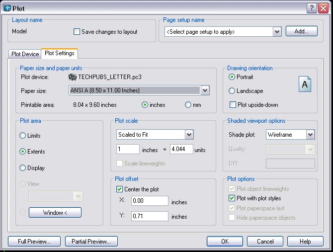

    I click on the Plot Settings tab and I change the settings around the way I want, if you use a previous plot you’ll have to go back to the Plot Device tab and re-select your new pens. Click on Full Preview to see if your pens are going to give you the result you want.
    0.5mm pens output
    2 mm pens output
    I typically plot to an eps file. I hope this is useful to you.
