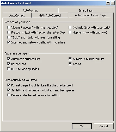

    No code at all solution:
    The first thing to do is turn off "replace straight quotes with smart quotes" in Word Auto Correct (and check the AutoFormat tab also).
    Then, click on replace, select a left quote in what to replace
    Put a straight quote in the replace with field.
    Click on replace all. The select a right quote and repeat.
    Then save your word document, This is from Outlook but Word has the same thing:
    [cid:image001.png@01CD5543.2DC816F0]
