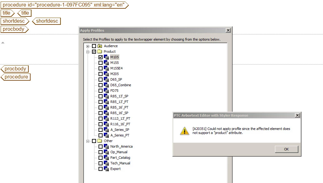

I am tring to profile a procgroup. My current setup does not let me do this. I have contacted PTC support and they said that I need to add the ability to profile to a procgroup. When I click on the the profiles window and add a profile it says could not apply profile since the affected element does not support a "product" attribute. How do I correct this? Where do I need to look? Is it in stlyer or is that a setting that I need to modify in one of the .pcf files.

    Hi Bryon--
    You would need to add the appropriate configuration in your DTD (or schema). Make sure the profiling attributes are defined for the target element, e.g. make sure there is a "product" attribute assigned to the procgroup element (along with other profiling attributes).
    If that doesn't solve it for you, you might need to make changes to your DCF and/or PCF as well. But assuming you want to apply the same profiling attributes (with the same list of values) and the same profile groups on the new elements as those you've defined for other contexts, I think you should be in good shape once your DTD is fixed up.

    Greetings,
    According to the screenshot you sent, your cursor is within an element called "textwrapper" (look at the first line of text in the Apply Profiles dialog). If you move your cursor to the <procbody> tag and then apply the profile, the profile should be able to be applied as DITA supports the @product attribute on the <procbody> tag.

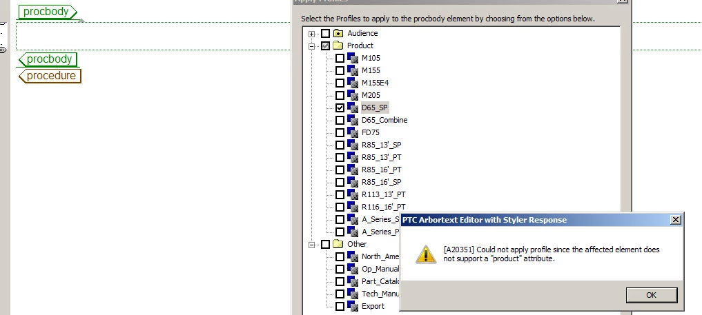

    Hello again,
    I don't know why I read 'procbody' as 'procgroup' Smiley Happy. It depends on what element procbody is derived from. Most all DITA elements have the profiling attributes defined in them (in the dtd or schema). I still believe your issue is because you are within the element <textwrapper> you may need to move your cursor to get to the procgroup tag to be able to profile that.

    Hi Bryon--
    No, it's nothing to do with the stylesheet. Anyway, profiling isn't enabled for <procbody> OOTB either, at least in the 6.0 implementation of SMA.
    Profiling is enabled for the top level <procedure> element. Maybe instead of applying the profile to procgroup, you could define different procedures for the different profiles? You could use conrefs to minimize duplication of content.

    With some guidance from PTC Tech Support. I located the smaprocedure.mod file. I located the element declarations from there I found the ATTLIST procgroup, I added%select-atts; to the list. I am now able to profile procgroups. Thanks for all the help.
    Is there anything I need to watch out for when testing this?
