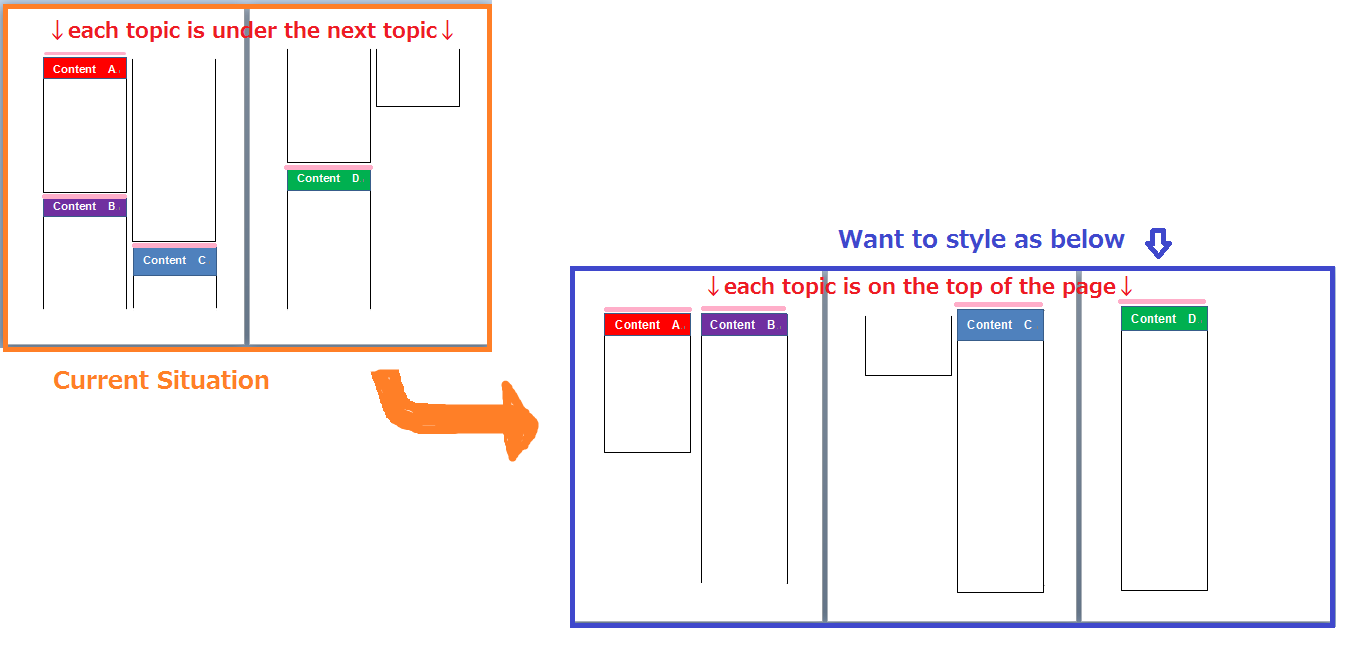

I created a book map with two chapters whick contain 4 or more topics in each and it is going to be published in PDF format.
Then, to save the number of page, I am trying to show two columns in one page and each topic should start from the top of the page.
However, Arbortext Styler does not have such function in its UI.
I am wondering if this can be achieved with some souce editting.
Do you know any source edit that works for this problem?

Check the breaks tab. I don't have Styler in front of me right now but you what you want is to set a "break before" of type "column", otherwise known as a column break. Set that for your topic (or possibly topic/title) and you should be away.
