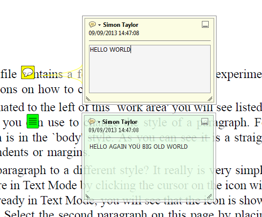

This is provided as a technology preview. Here, you get the ability to create PDFs with annotations (sticky notes) which can be populated with content extracted from your XML (inlcuding comments if you're smart). When you create the PDF note, you get to specify the title, the author, the content, the colour of the note and the icon used. Currently the icon is one of seven which are predeifined, but I'd be interested to hear if you want more. What I like about this feature is that it allows you to add information to a PDF, such as asking a reviewer a question or including deleted content, without changing the formatting of the page by adding extra content inline.
