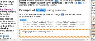

Hi, I am running Arbortext 6.0 and trying to get boxing to display in the editor window. I have seen past posts stating that boxing will NOT be displayed. However, in the help center, it shows that it should:
Could someone please clarify why boxing doesn't display, or can it be displayed?

Best answer by GarethOakes
FOSI is the original styling language of Arbortext. It supports both on-screen and on-paper (PDF) styling. The example you have found for boxing is relevant for on-paper FOSI. There are many limitations of screen FOSI and boxing is one of them.
July 21, 2022
