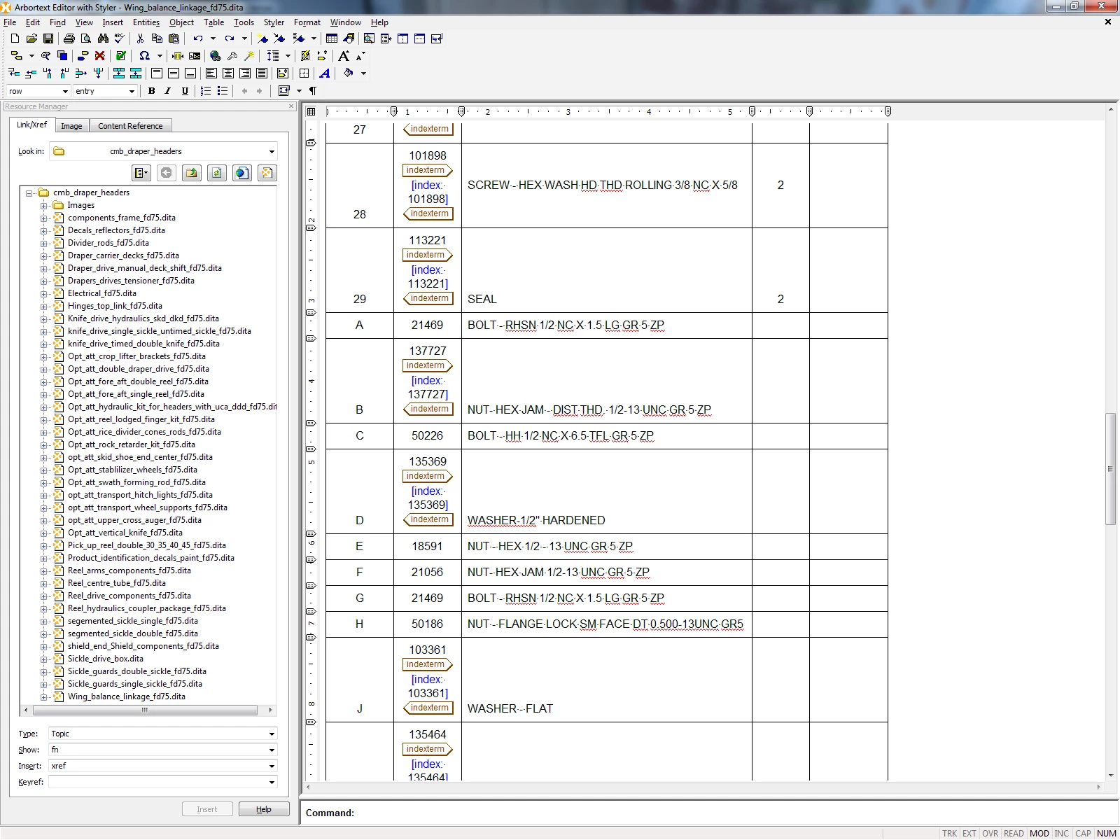

Hi I need some help creatinga macro that will copy the contents of a cell and create an index tag with those contents. I have created one but it only works with 6 digit numbers and only can do one cell at a time. We have a mix of 4, 5 and 6 digit part numbers. What I would like to do is select the entire column, maybe 20 or entries and run this macro and have an index tag created for each one. I cannot seem to change the amount of characters that I can select or number of cells as I seems to mess everything up if I do it that way
Here is what I got
#Enter;
insert_tag("indexterm");
LineUp;
CharLeftExtend; repeat 5;
EditCopy;
LineDown; repeat 2;
EditPaste;
Thanks Bryon

    Hi Bryon
    See below a simple ACL script which seem to do what you need.
    Also see the video demoeing it: http://communities.ptc.com/videos/2679
    $table_rows=tbl_row_count()
    while(tbl_caret_row() <= $table_rows && tbl_caret_row() > 0) {
    oid_select(oid_caret(0))
    copy_mark mymark
    insert_tag(indexterm)
    paste mymark
    # insert("-")
    if (goto_cell(tbl_caret_row()+1, 1) != 1)
    break
    March 19, 2012
    The code above always adds indexterm to the 1st column
    Here is the slightly updated code which adds indexterm to the column where cursor is located (haven't validated it - writing from home and I'm sane enough not to have Arbortext installed on my home laptop
    But it should work.
    $column_to_process=tbl_caret_col()
    copy_mark mymark
    paste mymark
    # insert("-")
    if (goto_cell(tbl_caret_row()+1, $column_to_process) != 1)
    break

    March 19, 2012
    Thank you Dmitry your knowledge of the product is great, again thanks for all your help.
    Bryon
