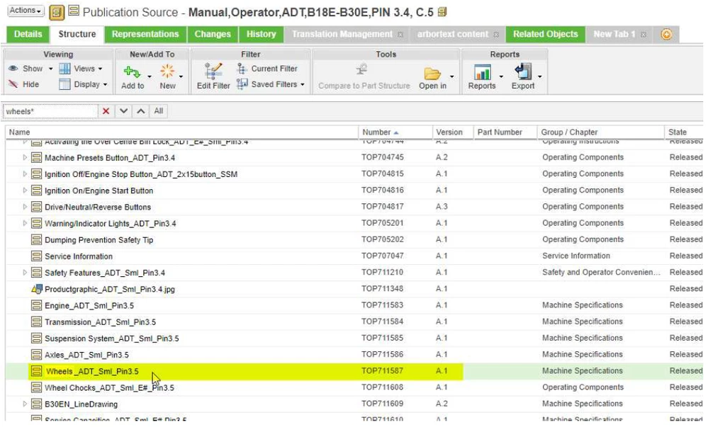

English map in Windchill... e.g. the WHEELS topic:

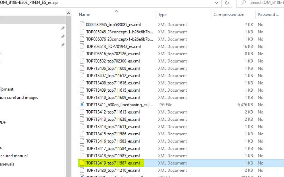

This topic is in the translation pack that I imported back into Windchill:

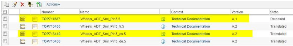

When I checked, this topic is visible in Windchill in our topics folder:

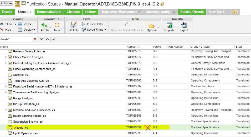

If I open the equivalent Spanish (es) manual in Windchill, the older Spanish topic is showing:
[topic did not update?]

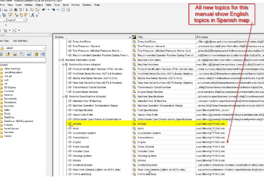

And when I open this Spanish manual map in Arbortext, the English topic is showing? (as well as all the new topics in translation pack - all still the English topic & topic no):
