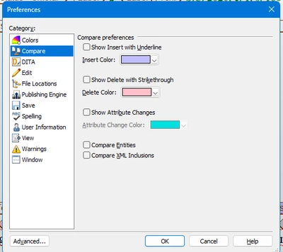

I am trying to convert the Insert and Delete Pub Tags that are used by Arbortext to indicate differences, into elements that are part of our DTD.   It would be convenient if I could either tell Arbortext to use our elements for the Diffs, OR even if I could use elements instead of the Pub tags.

Also, in the Arbortext help I see this line:
" Compare tab provides a choice between either wrapper tags or PIs (processing instructions named Insert and Delete) to mark the differences in content as insertions and deletions. "
However, I dont see anything like that on the screen.  Where can I make this "choice"?

I think I found a workable solution.  I found that the oid_find_children function did gather the Insert and Delete tags, even though they are not true elements.  So this code:
oid_find_children(oid_root(), $dels, 'Delete');
did actually work, and I was able to swap out the diff tagging to my own.
I still find it strange that the help pages says there is a choice, but I dont see a choice anywhere.

If you want to avoid using an ACL script to transform, you may be able to accomplish what you want using a combination of diffencltype, diffinsname, diffdelname, and diffattrmodname preferences. The elements you choose from your DTD for change tracking have to be able to appear anywhere in the document. See https://support.ptc.com/help/arbortext/r8.3.2.0/en/#page/Program/acl_ref/help452.html for more information.
