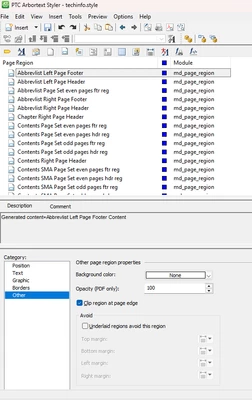

I am not a stylesheet expert. I wonder if you could set a page region for each page type and set the background color?
We do something close to what want. We have multiple stylesheets that are based off a master stylesheet. Then each stylesheet can have its own specific styling done to them, while maintaining the same look across all the manuals.

You might try creating individual pagesets with the background color set then use an ouputclass to call up the pageset.
under chapter eveywhere else you could a condition that if outputclass+blue then on that condition set it to use the blue page set.
