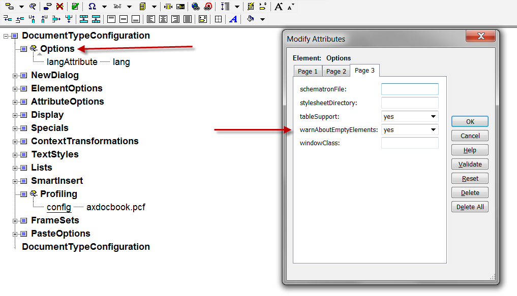

Best answer by Pushpinder_Toor
Hi Bob,
I would suggest you review how to do this by finding the Online Help topic titled "Disabling warnings about empty tags", This topic walks you through the steps to modify the correct categories in your DCF .
In a nutshell, you can simply open your DCF file in Editor and modify the correct options. Basically, there is an attribute- warnAboutEmptyElements - that we added to the <DocumentTypeConfiguration> element. By default it is set to "yes", change this to "no". See screenshot below. It is simliar steps to do this on an element by element basis and not globally for the whole document type.
Pushpinder
June 13, 2012
Hi Bob,
This feature was added in M040 based on customer requests that they have their empty tags flagged as warnings (not errors).
However, you can turn this warning off at either the document type level or on an element by element basis, via the DCF (.dcf) file. By default, the warning is always shown.
Pushpinder

June 13, 2012
Hi Bob,
Pushpinder
