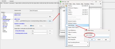

Arbortext Editor - Illustration titles
I've imported an illustration of three sheets into Arbortext Editor. How do I get the title to appear on each sheet, with the suffix "Sheet 1 of 3" etc? Currently the title appears on all three sheets, but if I add "Sheet 1 of 3", that's what appears on all three illustrations.

You probably need to add some XPath expressions to your gentext for the title. In the figure title Generated Text->After-text, try something like this:
·(Sheet·<_gte:XPathString expr="count(preceding-sibling::sheet) + 1"/>·of·<_gte:XPathString expr="count(../sheet)"/>)
(This is assuming your sheet element is called <sheet>. If your doctype uses something else, change the element name in the XPath expressions accordingly.)
Note the _gte:XPathString items are added using Insert->XPath String from the menus in the gentext editor. The first expression counts how many sheets precede the current one (and adds 1 so that we start from 1 instead of 0), and the second expression counts the total number of sheets in the current container (presumably a Figure or something similar).

Hi @ClayHelberg - many thanks for your detailed answer. I'll give it a try and let you know the outcome.
