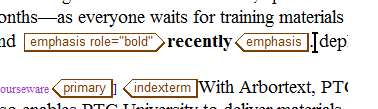

we use the Arbortext Editor Version 6.1. If we delete a character after an inline element, arbortext deletes also the space:
You can see this in this example:
As you can see, the cursor is placed after the emphasis - element.
If we would like to delete the point character with backspace, Arbortext deletes also the space character:
That is absolutely not desired. Is there maybe a setting/option to change this behaviour?
Thank you for your help in advance.
Best answer by ClayHelberg
Hi Hubert--
Try this:in Preferences, click Advanded, find the "deletespaces" option, and set to "off".
Or, in an ACL startup script, add the line
     set deletespaces=off
--Clay

Hi Clay,
perfect! That was exactly what we were looking for.
