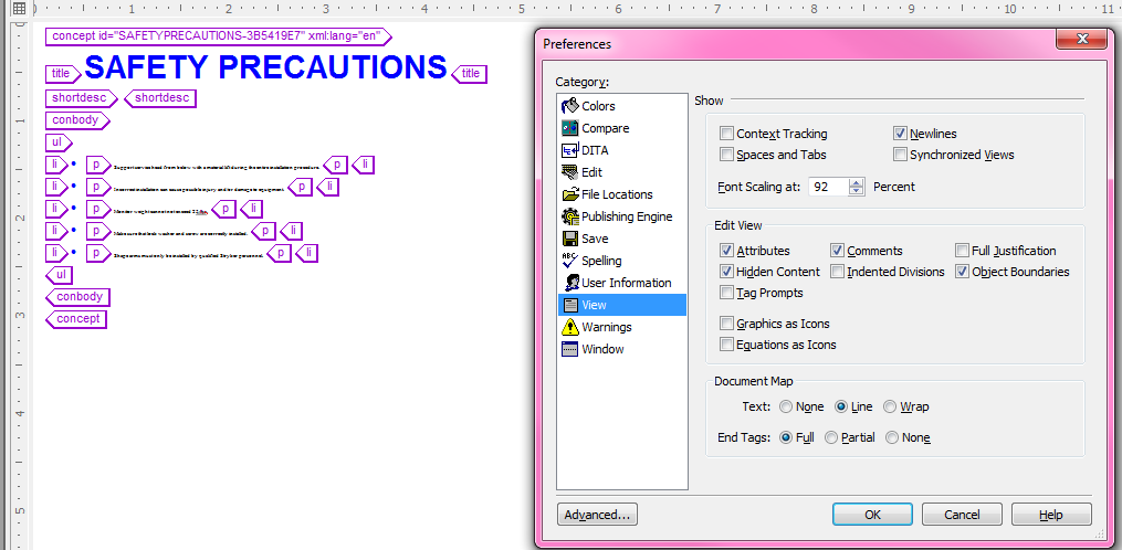

If I set my preferences to match those of my teammates, it looks like this:

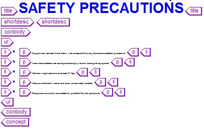

In order to make the text readable, I can use the "set fontpercent=" function, but have to put it at something crazy like 200 or higher. Then I get something like this:
Its workable, but not optimal, and rather annoying.

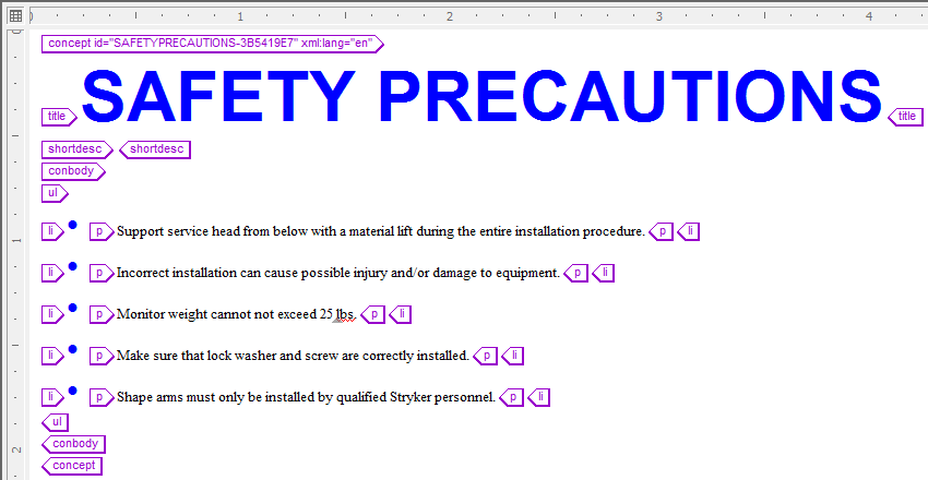

The problem I have is the size of the text font and tag fonts in comparison to each other. I would like them both to be a normal size together, as opposed to one being gigantic and one being miniscule. This is what I get when I open a topic:
