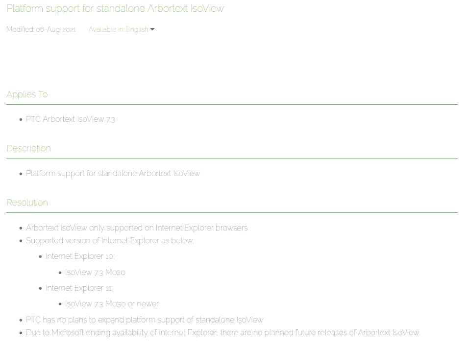

I would like to know if Arbortext Isoview is compatible with chromium navigators, like Edge Chromium.
Apparently not, is there a way to make it compatible (or is using Internet Explorer the only way to make Isoview work?)?
Thank you.
September 18, 2021
Article "Platform support for standalone Arbortext IsoView": https://www.ptc.com/en/support/article/CS170574
