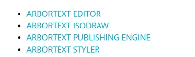

I just wanted to ask regarding Arbortext layout editor. Is this a standalone software or does it work when you install Arbortext editor? Upon checking the software download tab I only see the Arbortext  editor and no Arbortext layout editor.
