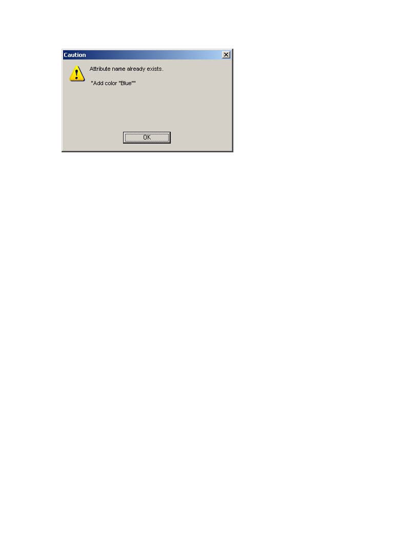

Hi evrerybody,
Here is my probleme, i try to create automatic attribute in macro like adding colors, pens, linestyle etc... that part works good, but in some case some pens, colors, already exist so it bug my macro... I try to modify macro to fit something like that:
If color "ABC" does'not exist...
Add color "ABC" then
If color "DEF" does'not exist...
Add color "DEF" then...
and same for pens, linestyle, shadows, etc.
Many thanks for support!!!
PS; hers goes my actual macro under error example

Add color "Blue"
App.colors["Blue"].kind = "RGB_color"

    September 13, 2013
    you could try this for the pens..........
    if (exists (activeDoc.Pens["LeaderWithMask"]) = false) then
    ADD PEN "LeaderWithMask"
    else
    end if
    September 15, 2013
    managed to work this out.................
    if (exists (activedoc.colors["MY_COLOR"].name) = false) then
    Define MY_COLOR as ColorSpec
    MY_COLOR.type = "rgbValues"
    MY_COLOR.rgb.red = 0
    MY_COLOR.rgb.green = 255
    MY_COLOR.rgb.blue = 255
    Add color "MY_COLOR_Name" MY_COLOR
    else
    end if
