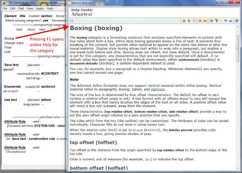

The next graphic shows how easy it is to get help information for FOSI formatting properties. Just click on a category and press F1.
