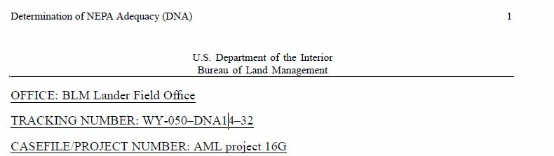

Really basic quesion I'm sure - how do I center text as in the image added?
I'm working in a style sheet that has already been created, but if this office can do it, it's in the style sheet. Might not be using the most proper Arbortext lingo, if so sorry............?? Thanks!

    Mary,
    Epic supports several different stylesheets, FOSI, XSL-FO and their Styler.
    Each does things a bit differently though the basic premise would be pretty
    much the same.
    If you have a good ASCII text editor (a good freebie is Notepad++) I'd
    search through the stylesheet(s) for the element <thead> (the most COMMON
    element name for a table header if you are using either the CALS or Exchange
    table model). Once you have found that area in the stylesheet, look for
    something about alignment. There may be a horizontal and vertical option,
    you'd want the horizontal.
    I kind of recommend Notepad++ or other apps like Codewright (no longer
    supported but still available) or Ultraedit that support multiple file
    searches and regular expression searches. This makes finding things a bit
    easier.
    Then set the value to 'center'. If it is already centered, then you have
    other problems.
    If you are using a FOSI or Styler, Epic can open these files in Epic and you
    can search for formatting rules and make changes that way.

    Mary,
    Do you know what kind of stylesheet is being used? A quick way to find out
    is to type this on the Epic command line.
    eval stylesheet()
    Then hit enter. This will bring up a window with the full path and name of
    the stylesheet that is being used.
    Once you find the type of stylesheet, let us know and we can get you some
    more detailed help.
