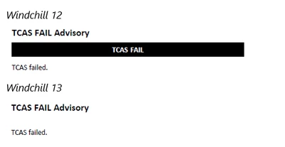

Hi, my company uses the block structure in certain Arbortext content. Recently, we migrated from Windchill 12 to 13 and lost this formatting/text when publishing.
We are using Arbortext w/ Styler 8.2.3.0. Please let me know if you need additional information.

For further clarification, the topic published correctly under the previous installation of Arbortext (8.1.1.0). When my company upgraded to Windchill 13, we were required to upgrade Arbortext to 8.2.3.0 to maintain access. Therefore, we no longer have the option to use 8.1.1.0.
I have tried PTC Support steps for updating stylesheets (https://support.ptc.com/help/arbortext/r8.3.0.0/en/index.html#page/admin/admin/help8023_2.html) but didn't receive any prompts to update.

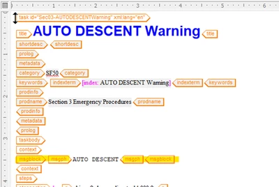

Hi, I am still unable to resolve this issue. Here are more details:
Viewing content in Arbortext w/ Styler 8.2.3.0, the topic displays as expected:

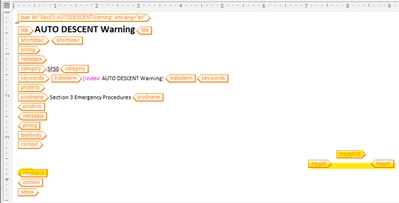

However, when I open the stylesheet for this document, the display changes to this:
The text "AUTO DESCENT" remains in the msgph element as white text. When published to pdf, the output displays as follows:

The Error Log lists this for that particular page in the published PDF:

JSkog12-AmethystAuthorAnswer
Oct 20, 2025 3:45 PM UTC
I was able to resolve this by editing some settings in the block border category that seemed to replicate whatever feature had changed.
