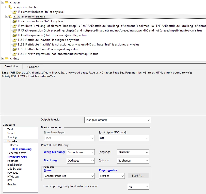

Breaks > Start new > Odd page works on all chapters except first
I need each chapter in my document to start on the right-hand side. In my stylesheet, on the chapter element, on the Breaks tab, I have set "Start new" to "Odd page". This works for every chapter except the very first. I am using this stylesheet with bookmaps which include frontmatter before the first chapter. I experience the same behaviour across different bookmaps.
