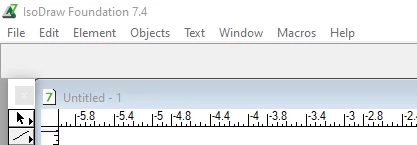

Ok I think I am having a brain fart here! I have updated to IsoDraw 7.4 when it is installed this is what my banner looks like. Screenshot 2023-03-14 142716.png

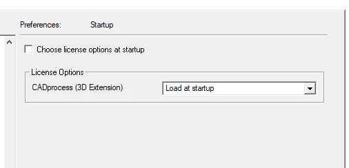

In my preferences I have load 3D CADprocess load at startup checked.
What I need to do to get CADprocess to activate in my IsoDraw session?

I would check the license file and see if CADprocess is listed on it. We have both and my pref screen looks like yours

Checked the license it did not show CADprocess. I am now checking with the support group to see if we can get the proper license. Will let you know what happens.
