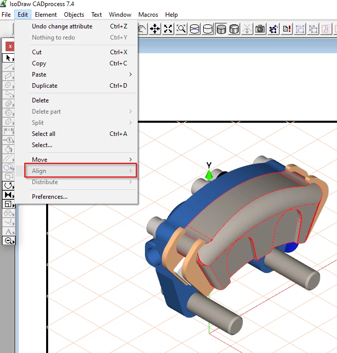

CADprocess 7.4 Edit>align greyed out.
There was a lot of templates and macros used, Now the Align function and buttons are greyed out.
I will re-install ISO in couple days if no solutions so i can keep moving forward.

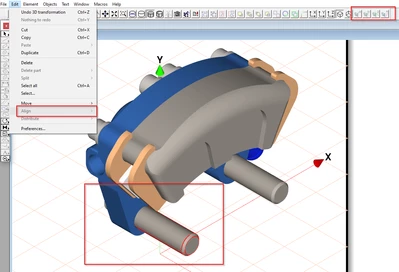

On the part you want to align, you need to select the 3D axis to align to.

Yep, all greyed out., this is a import 3D step part..... yeah, guess i will reinstall the software....
