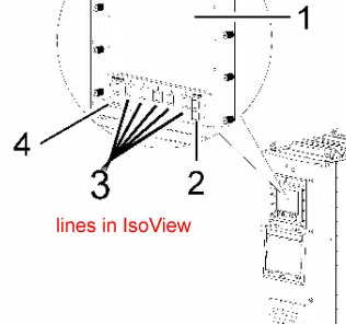

I have 5 objects that use a single callout number. If I try to use 5 callout lines, the shadows from each one cover the ones below. I need them all to have shadows over the lineart below. I tried using a polyline that zig-zagged back over itself so that it could point out all the objects, but I am being told that in the final proprietary viewer, the lines dont look like they do in Isodraw. Any ideas?

    This is how those polylines look in IsoView.

    The only way around this that I have found is to place a line segment about half as long as the leader line (of the same pen, with no shadow) on top of the leader line that is being masked by the shadow of the other leader lines. Pop all of your shadowed leader lines above the lineart, and the short segment(s) above the shadowed leader lines.
