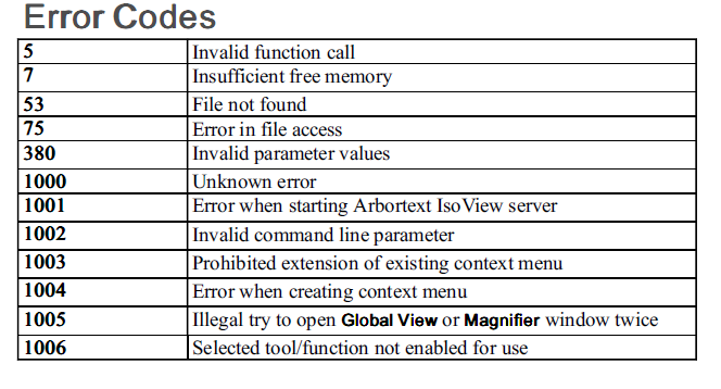

Hi Rich,
What version of IsoView are you using? Here's a list of error codes from "Arbortext IsoView 7.2 Programmer's Reference" PDF guide (which can find it in attachment).

Thanks for the Programmer's Reference, Vladamir. I didn't find a reference to Error code 16 or the more common Error code 50 listed there, but hopefully it will be helpful to others.
