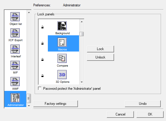

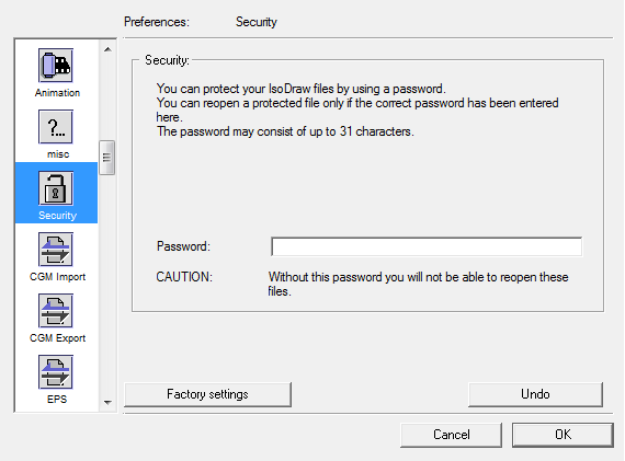

Hi everyone,
I am creating File or Database management system for my project using macro, so i need to secure my my .ism datas.
I would like to know whether is there any option to Lock .ism files.
And also I woluld like to know there is any option to automatically update macros while working. ie. I have a macro which would create new .ism files and run the same. But while a macro is running the newly created macro by a macro does not have any effect. Later we have to manually update.

    January 20, 2012
    Hello!
    You may also use the following useful features of Arbortext IsoDraw (in main menu select "Edit" -> "Preferences" then scroll down to):
    1. "Security" tab.
    2. "Administrator" tab (last in list).
