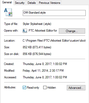

Jul 6, 2017 9:27 PM UTC
As another option, you can simply right click on the stylesheet and mark it read-only.
