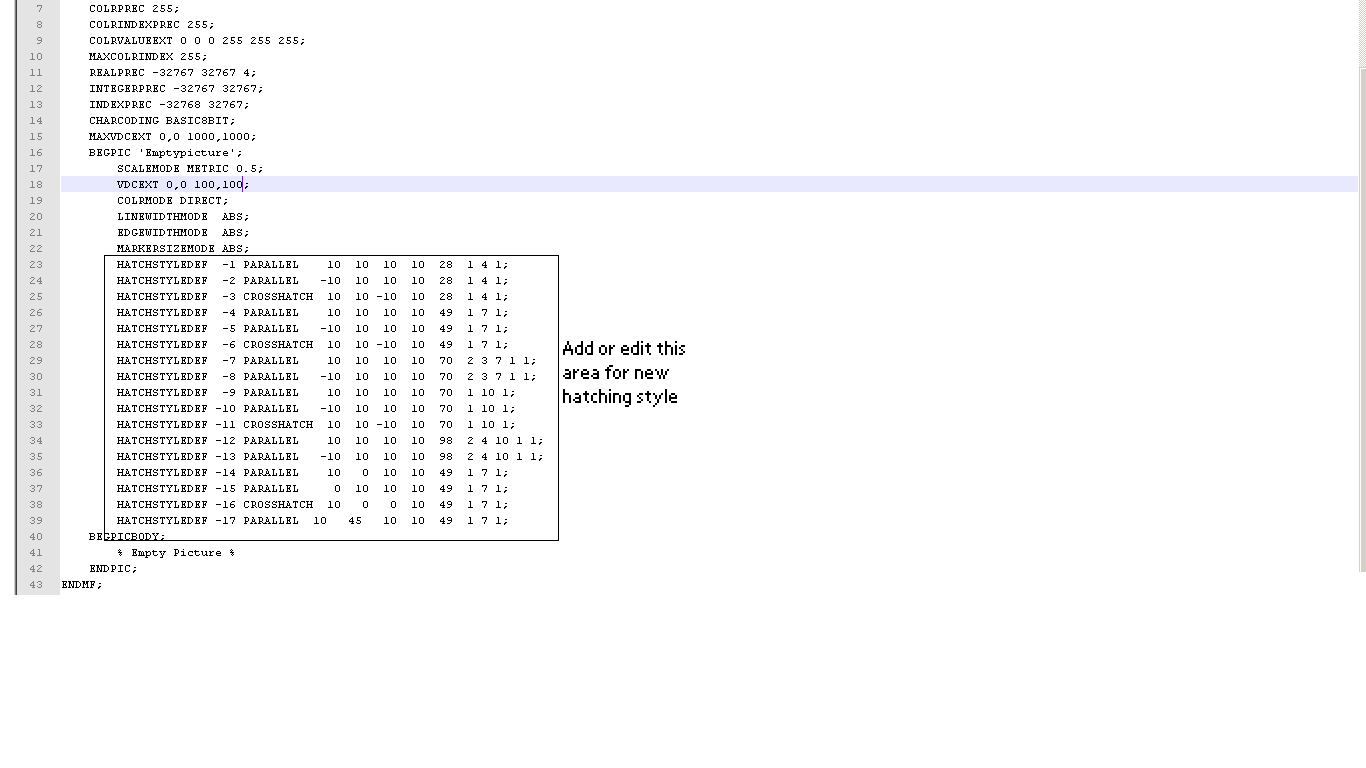

    1. You can use macro example ("MACRO Generate_Hatchings") that create hatchings with diagonal lines of a defined distance from each other for IsoDraw: http://communities.ptc.com/servlet/JiveServlet/download/182842-38438/HatchGenExample.txt.zip
    2. Try to edit "Cgmhatchings.cgm" by using any text editor:
    http://communities.ptc.com/servlet/JiveServlet/showImage/2-183315-33585/CGM_HAtch.PNG
    More comments can be found in this topic: http://communities.ptc.com/thread/38562
