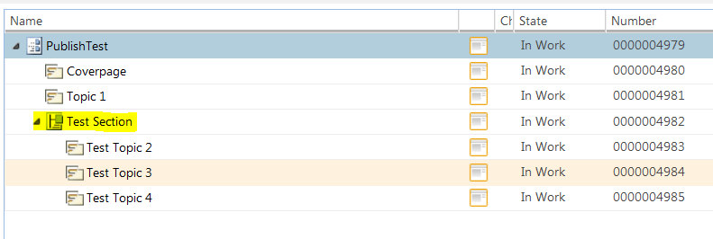

Can you create a xref to publication section (Windchill)?
I want to create a link(xref) to a publication section in a publication structure that's in Windchill not a section in the topic self.
When searching in Windchill with the Resource Manager for Link/xref I can't find a publication section only topics no matter which type is selected.
In Arbortext Editor I can only link to a topic or image.
Does anyone know if this is possible to create a link to a publication section?

Nov 7, 2016 8:11 AM UTC
Tim, thanks for your quick reply.
I read the topics in the Arbortext Editor Help Center but I still can't find how to create a reference to a Publication Section.
I also tried to search the Publication section in the resource manager with type on 'any' and 'show all elements' but still no Publication Section in the resource manager.
Below a image to make clear what I mean with Publication Section. It's not a element in a topic or a dita file but a object in Windchill that is used in Publication Structures.

Jan 13, 2017 12:59 PM UTC
You cannot link to a publication section. A publication section is a set of topic objects. See Arbortext Editor's Help Center topic "Working with a Publication Structure".
Using the Arbortext Editor's Resource Manager, one can navigate to locations and link to element in the objects navigated to.
See "Link/Xref Tab" subtopic "Search CMS" in Arbortext Editor's Help Center.
