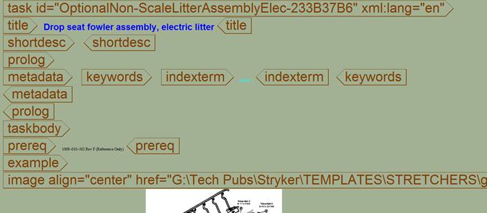

Does anyone know how to change the tag display size in Arbortext Editor? A teammate has somehow made her tag display size very large and is not sure how to set it back to normal size?
Thanks for your help!

At the command line, enter set tagfontpercent=100 to restore the original size. Use larger or smaller values to increase or decrease tag size. Use set fontpercent to resize text.

If you are in editor, hold ctrl and use the scroll wheel on the mouse. It changes the font size on my machine.

As Suzanne states, tagfontpercent will modify just the tag size.
Bryon's method will modify both the tagfontpercent and editfontpercent at the same rate.
