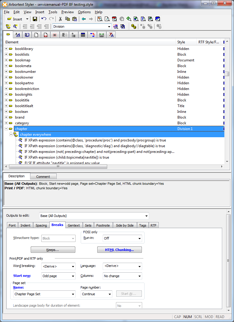

Hi there, I am trying to use the customized style sheet that we had created for us to do our operators manuals to also create a parts catalog. My issue is that I am wanting my graphic to always show up on the even page so the graphic to text will always be side by side. I cannot figure out what setting I should change in my stylesheet. I have added each topic to my ditamap at the chapter level.
In styler under element I have changed my chapter, breaks, start new to "even". That did not fix it.
Is this where I should be thinking about modifiying this setting?

    I'd double-check that you added the "Start New" - "Even Page" to the right context for the element.
    Also, using "Edit - Edit Resolved Document for Styling" helps when editing stylesheets and people often forget about this feature.

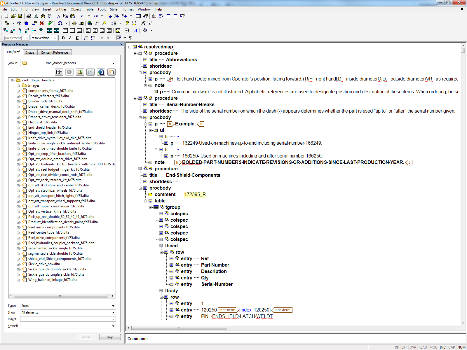

    If you could provide a screenshot of a) the ditamap/bookmap document with View - Document Map enabled and b) the Edit For Styling view of the same document (again, with View - Document Map enabled), I could, perhaps, generate a few more ideas.
    I think I have the requested pictures. I tried it again set it to even, then published then set it to odd and then published. My first page still shows up on page 1 of the book and page 9 the actual pdf in both cases. I have found that if I switch the margins from left to right and right to left, I need to delete one blank page and it will print a hard copy correctly.
