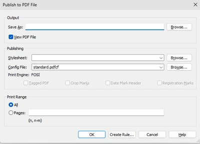

I want to ensure the print publishing (print composer) floating license is released after publishing to PDF.
I have implemented using an instance.acl file to add a menu item called "release print license" using the command license_release(PrintPublishing)
menu_add -before .File.Publish.#7 "Release Print License" -cmd {license_release(PrintPublishing)}
But I am stuck on how I should go about bringing up the publish pdf dialog box, putting in all the arguments, THEN releasing the print composer license. Or perhaps, the release_license is triggered by the end of the build process.

To make a button to publish PDF and then release the license, you could edit the instance.acl file and add the following:
# This adds a menu item in position 1 to
# File > Publish > called "publish pdf and release print license"
menu_add -before .File.Publish.#1 "Publish PDF and Release Print License"
menu_change ".File.Publish.Publish PDF and Release Print License" -cmd {
 compose_pdf(); #publish dialog box
 license_release("PrintPublishing"); #release print composer license
