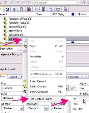

    If you do find you need to "hand tweak" the native APP code under the hood
    then get ready to do some learning J You can use the "Edited Source" feature
    of Styler to add custom APP commands.
    BTW, after you select the APP print engine in Styler (File -> Stylesheet
    Properties -> Print/PDF Options), you can also choose to associate an APP
    "template" (.3F file) with the Styler stylesheet. This allows for some very
    advanced functionality indeed, but to make the .3F file you would need to
    also have the APP Desktop software.
